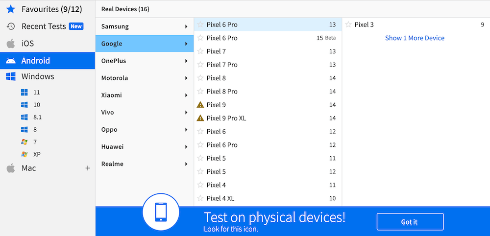

The BrowserStack Live dashboard allows you to choose what device and browser you want to test on — platforms on the left, devices on the right. Select a device to see the choice of browsers available on that device.
Test Choices
Clicking on one of those browser icons will load up your choice of platform, device, and browser — choose one now, and give it a try.
Test Devices
You can enter URLs into the address bar, scroll up and down by dragging with the mouse, and use appropriate gestures (for example, pinch/zoom, two fingers to scroll) on the touchpads of supporting devices like MacBooks. Not all features are available on all devices.

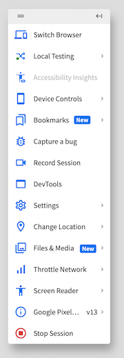

You'll also see a menu that allows you to control the session.
Test Menu
The available features vary depending on what browser is loaded, and can include controls for:
  • Displaying information on the current browser
  • Switching to other browsers
  • Testing localhost URLs
  • Setting zoom level and toggling orientation
  • Saving and loading bookmarks
  • Capturing/annotating screenshots and filing bug reports
  • Accessing browser DevTools
  • Changing reported location
  • Throttling the network
  • Accessing screen readers

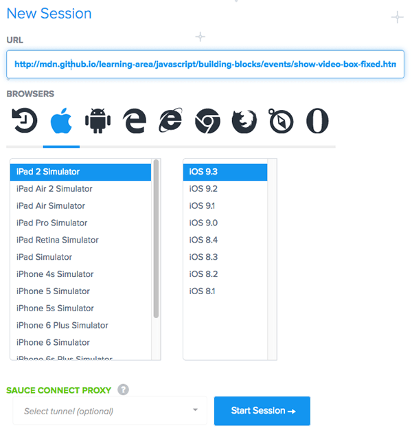

The Sauce Labs dashboard has a lot of options available on it. For now, make sure you are on the Manual Tests tab.
  1. Click Start a new manual session.
  2. In the next screen, type in the URL of a page you want to test (use https://mdn.github.io/learning-area/javascript/building-blocks/events/show-video-box-fixed.html, for example), then choose a browser/OS combination you want to test by using the different buttons and lists. There is a lot of choice, as you'll see!select sauce manual session
  3. When you click Start session, a loading screen will then appear, which spins up a virtual machine running the combination you chose.
  4. When loading has finished, you can then start to remotely test the website running in the chosen browser.Sauce test running
  5. From here you can see the layout as it would look in the browser you are testing, move the mouse around and try clicking buttons, etc. The top menu allows you to:
